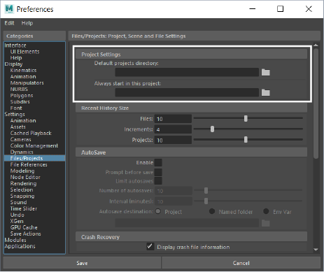

To select a different default location for your project
  1. Select Windows > Preferences from the Maya main menu.
  2. Select the Files/Projects category and in the Project Settings area, set a location as the default projects directory.
    Next time you create a new project by selecting File > Project Window and clicking New, the project will be created in the location you specified.
    You can also set a directory so that Maya starts with this project each time.
Note: The Files/Projects category also has information on auto saving your files, as well as where to save the auto saved files, and in what time intervals.
