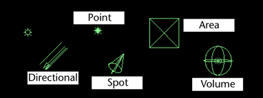

You can interactively adjust the attributes of certain light sources in a view using light manipulators. Light manipulators display in scene views (or, in some cases, the light source’s view, if you look through the light source). You can:
- Position lights
- Move the Cone Radius of a spot light
- Move the Penumbra Radius of a spot light
- Move the Decay regions of a spot light
- Move barn doors (shutters) of a spot light
