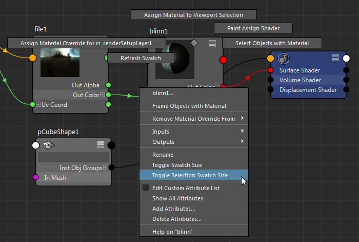

Alternatively, you can right-click the node and selecting Toggle Swatch Size or Toggle Selection Swatch Size from the node marking menu.
Toggle Selection Swatch Size affects all selected nodes. Toggle Swatch Size affects only the node from which you selected the menu item.
