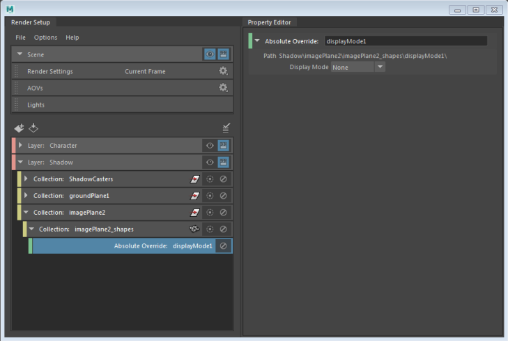

Render Setup editor. The
Render Setup workspace window appears, with the
Render Setup editor on the left and the
Property Editor on the right. The
Render Setup editor allows you to create layers, collections and overrides, while the
Property Editor allows you to set their corresponding values.
You can change the layout of this workspace by docking, undocking and rearranging as follows:
- Undock the
Property Editor window so that it is a separate window.
You can then dock the Property Editor and the Render Setup editor into the main Maya interface.

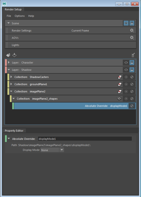

- Undock the
Property Editor window and redock it into the
Render Setup workspace so that it sits on top of the
Render Setup editor, or below, or to the right or to the left.
