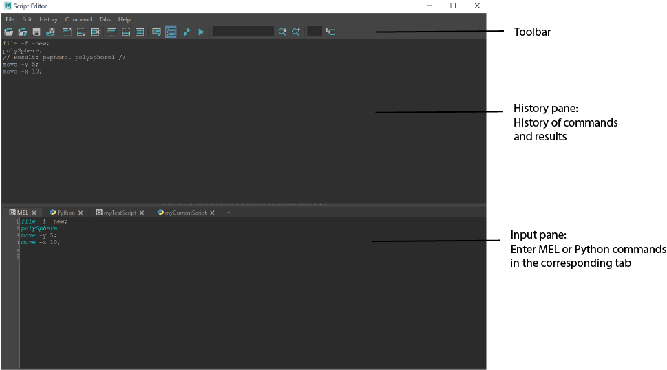

The Script Editor lets you type in single or multi-line scripts in a MEL or Python tab and see the output in the history pane.
The history (top) pane shows the history of commands and their results.
In the input (bottom) pane, type commands and scripts in the MEL or Python tab.
A MEL or Python icon appears on each tab to denote its language, so you can differentiate between MEL and Python tabs without the need to select them.

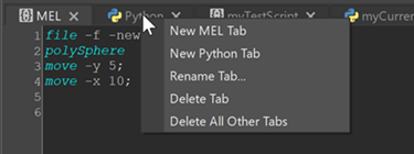

To create, close, or rename tabs
Do one of the following:
Select the option you want from the Tabs menu.
Note: Previously, these options were available from the Command menu. -
Right-click a tab and select from the available options.
Right-click either the input or history pane, and select the option you want from the marking menu.
Use hotkeys. See the Tabs section in Script Editor menus and hotkeys.
- Middle-click a tab to close it.
