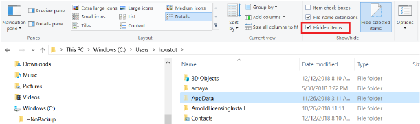

The default location for TEMP on Windows is \Users\[username]\AppData\Local\Temp\. The AppData directory on Windows is hidden by default. You will need to go to the View tab on File Explorer and select Hidden Items in the Show/hide section to see this directory.
