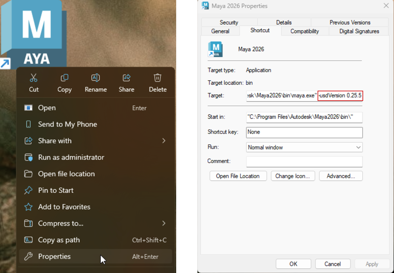

USD for Maya 0.33 or later includes both USD 24.11 and USD 25.05 builds for Maya 2026.2. By default, it uses USD 24.11. To switch to USD 25.05, follow one of the options below:
  • Option 1: Use the -usdVersion flag
    • Windows: right-click the Maya icon on your desktop, select Properties, and in the Target field, add the launch parameter -usdVersion 0.25.5 after a space at the end of the path.
    • Mac: open Terminal and run open -a /Applications/Autodesk/maya2026/Maya.app --args -usdVersion 0.25.5.
  • Option 2: Manually set the environment variable. This will override the -usdVersion flag if both are used.
