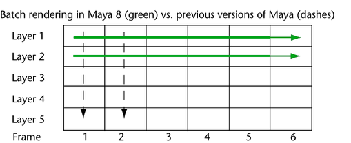

When command-line rendering in previous versions of Maya, each render layer of a frame was rendered before moving on to the next frame.
In order to properly support the use of different renderers with different layers in Maya 8, rendering from the command line (render) renders all frames of a particular layer before moving on to the next layer, as seen in the following diagram.
Previous render behavior is shown by the dashed arrows; current render behavior is show with the green arrows. Layers are rendered in the order they appear in the layer manager.
This may have an impact on dispatchers and other render managers because scripts that are triggered by completion of a particular frame won’t be triggered until the last layer is being rendered.
The frame/layer order of processing in batch and command line is required for maximum efficiency. Switching layers has an impact on render processing due to the need to update all the attribute overrides.
