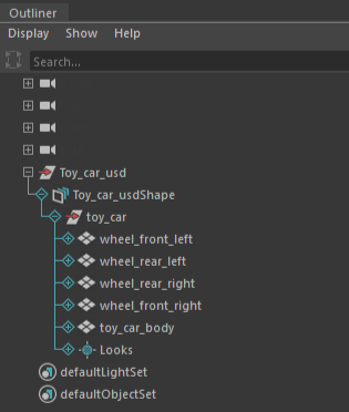

USD data in the Outliner
USD Data Branches in the Outliner
The mixed data model: to distinguish intrinsic Maya data from USD data in the Outliner hierarchy tree, USD data features a unique default data branch color of aqua.

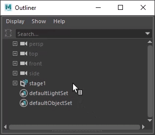

USD Stage (proxyShape) display in the Outliner
After creating a stage, Maya creates a transform node and a proxyShape node. The proxyShape node points to the USD file and appears in the Outliner. In the following example, stage1
is the transform node and stageShape1
points to the newly created USD stage or proxyShape node.
