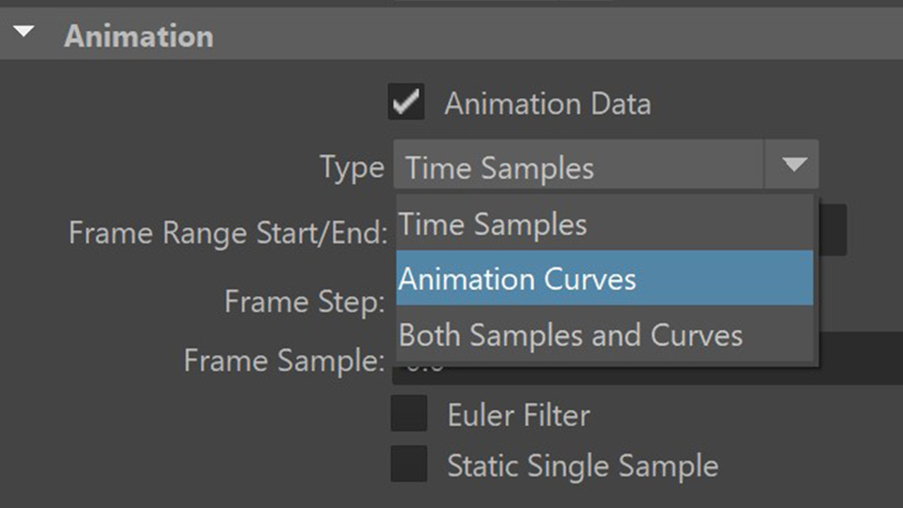

Animation Curves for camera attributes. The USD Exporter now supports animation curves for camera attributes such as aperture and focal length.

| Animation curves are not fully implemented in USD 24.11 or in Maya USD 0.32. Currently, only camera attributes are supported for export. Animation curves on other attributes, such as light attributes or transforms on objects, are not supported in export. Import of animation curves is also not supported. |
