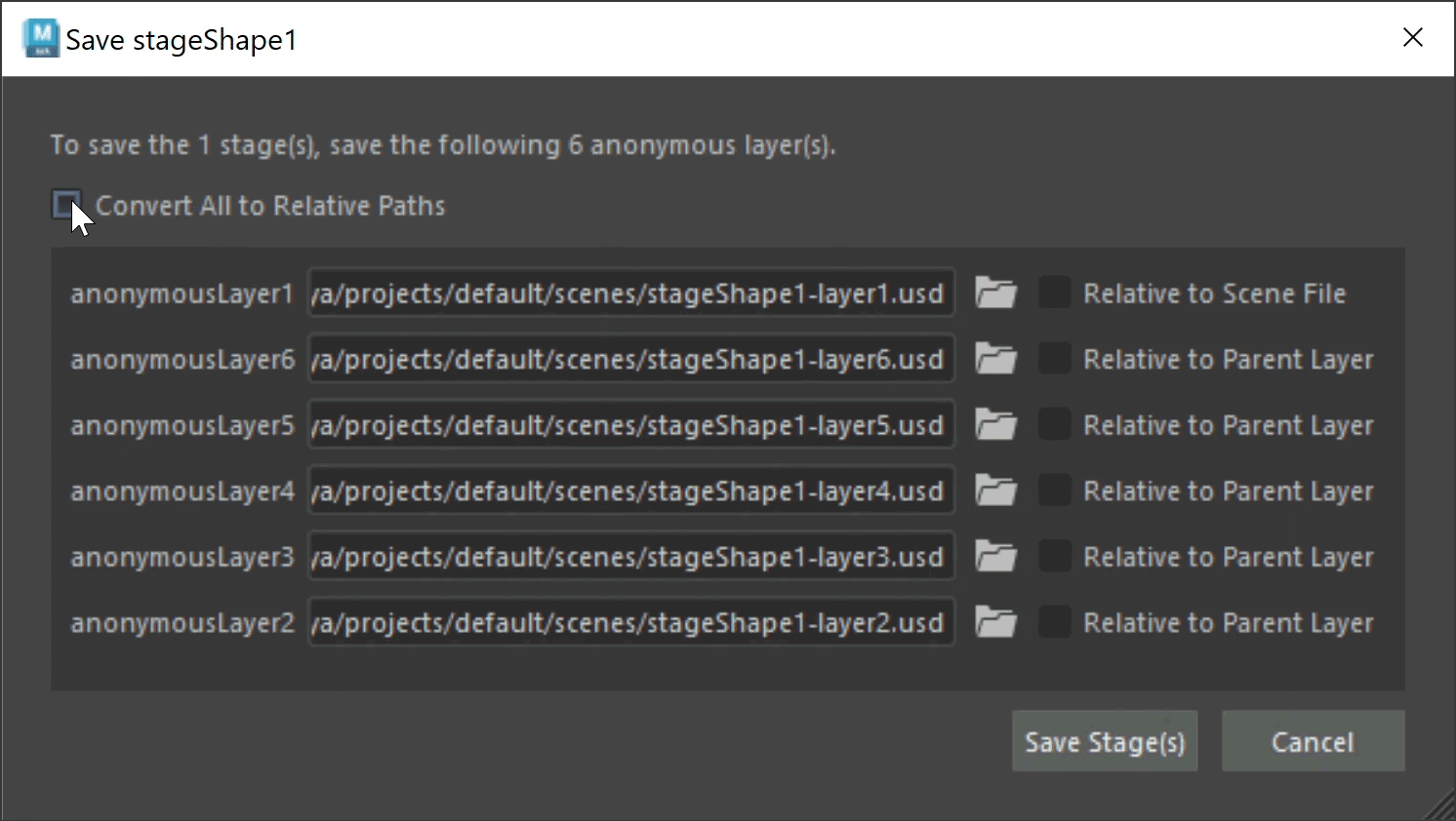

Bulk save USD files relatively
  1. When you have an anonymous USD root layer file, and there is no Maya scene file saved to disk, click on the bulk save icon for your stage in the USD Layer Editor.
  2. Do one of the following as necessary to save your root USD layer as relative (this enables any other USD files in your hierarchy to be saved relatively as well):
    • Select Relative to Scene File beside your root USD layer (anonymouslayer1).
    • Click the folder icon beside the root layer (called anonymouslayer1). The Set As dialog appears. Here you can name your file, locate a directory and select Make Path Relative to Scene File. Choose a directory, name the file and click Set. Then, in the bulk save dialog, you will see the path populated beside anonymousLayer1 is the file name only. Tip: if you hover over your root layer (anonymouslayer1), you can see the tooltip indicating the directory or resolved path for your Maya scene file if it has been saved to disk.
  3. Do any of the following to configure relative or aboslute paths for your files other than your root layer:
    • Click Convert All to Relative Paths (recommended).
    • Individually select checkboxes next to your anonymous layers to make them Relative to parent layer.
    • Click the folder icon beside any layer to open the Set As dialog to locate a directory and select Make Path Relative to Parent Layer.
  4. Key in inputs for your paths as necessary:
    • When you set a layer as relative, you can directly type into the file input and your file name will be preserved.
    • If you directly type into the input a relative path like this ..\..\layer1.usd. This path and it's child layer's tooltip will update. This ensures your parent layer directory is mapped and any descendants when set as relative can be directed to that. As such, any parent/child layer directories sync updates as you toggle these checkboxes.
    • Verify your relative pathing by ensuring you don't have errors or warnings from the Script Editor.
  5. Click Save Stage(s). The following occurs:
    • The USD root file is now saved as a relative path to the directory of the Maya scene file, once you save your Maya scene file.
    • In the Attribute Editor, the File input when you have your stage selected is the absolute path of the directory you chose in the Set As dialog. This path changes to the relative path once you save your Maya scene file to disk.
