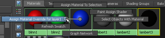

To override materials and shaders on a per layer basis: method 1

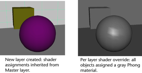

- In the Render Layer editor, select a layer.
- Select Windows > Rendering Editors > Hypershade.
- Select a material from
Hypershade, or create a new material, and assign by right-clicking and choosing
Assign Material Override from the marking menu.
This creates a material and assignment that will override all shader assignments to objects on the current layer.
