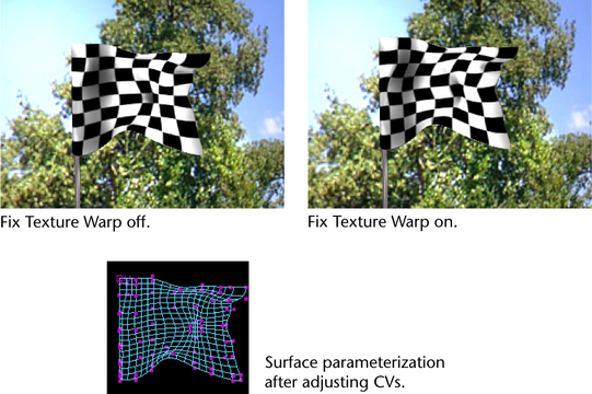

Fix Texture Warp adjusts a texture’s UV parameters so the texture does not rely on a NURBS object’s UV parameterization, which alleviates texture warp on objects with 2D textures. For example, if you want to create and animate a flag with a Checker texture, you can create a NURBS plane on which to map the Checker texture, transform the CVs, and turn Fix Texture Warp on in the object’s Attribute Editor.
When you animate the flag by moving some of the CVs to simulate the wind blowing the flag, the checker pattern on the flag expands and shrinks appropriately.
