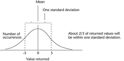

If you were to execute gauss(5) repeatedly and chart the values returned, they would occur roughly with this frequency:
