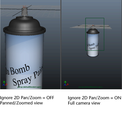

You can easily toggle in and out of pan/zoom mode. You can even create two panels and display the full camera view in one panel and the pan/zoom view in the other.
The pan/zoom mode does not render by default and therefore you have the option of rendering the full camera view or the pan/zoom view. In addition, you can also create 2D Pan/Zoom bookmarks.

View > Camera Settings > Ignore 2D Pan/Zoom is turned off so that you can see the panned/zoomed view in your scene view.

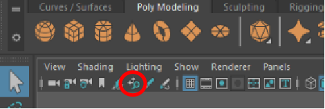

You can also select Ignore 2D Pan/Zoom by right-clicking the
icon in the Panel toolbar.

- Click the
button in the Panel toolbar to toggle between enabling and disabling the
2D Pan/Zoom.
