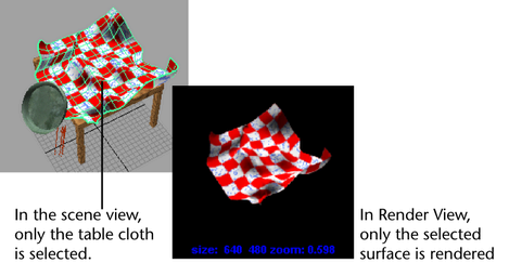

You can isolate specific objects to render. Note that when using IPR rendering, you must perform another IPR render before you can see the effect of this change.
To render selected surfaces
- Select the objects you want to render.
- In the Render View window, select Render > Render Selected Objects Only.
Render the scene.
