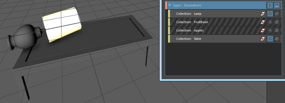

In this example, the Lamp and Table collections are set as isolate selected and appear in the viewport.

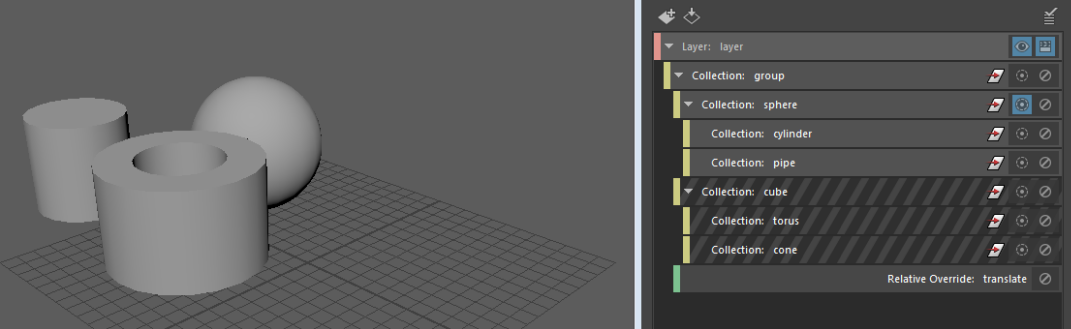

If you isolate select a parent collection in a Render Setup that consists of hierarchical collections, all of its child collections remain enabled, and their members remain visible in the layer.

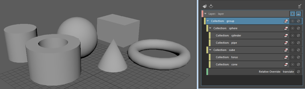

Before Isolate Select:
After Isolate Select is enabled for the sphere collection, the cylinder and the pipe subcollections remain enabled and their members are visible in the viewport.

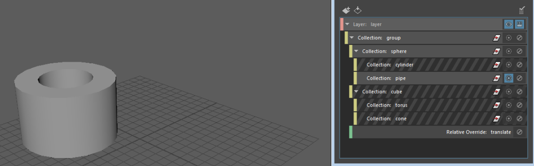

If you isolate select a child collection in a Render Setup that consists of hierarchical collections, parent collections are enabled but their member objects do not contribute to the render layer.
In this example, when you isolate select the pipe collection, only the pipe appears in the viewport. The sphere parent collection remains enabled, but the sphere that it contains does not appear in the viewport. This allows overrides on the parent collection (in this case the Translate override that is applied to the group collection), to remain applied to the pipe collection.
After Isolate Select is enabled for the pipe collection:
