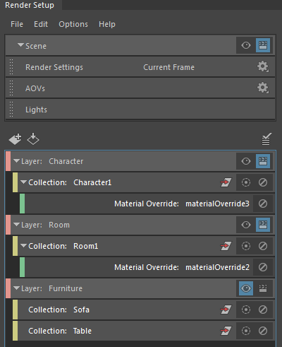

In this example, the masterLayer, Character and Room layers are rendered during batch render as they are denoted as renderable by the
icon.
Only the Furniture layer is rendered during interactive rendering as it is set to visible. This is true even though the layer is set to non-renderable
for batch rendering.
