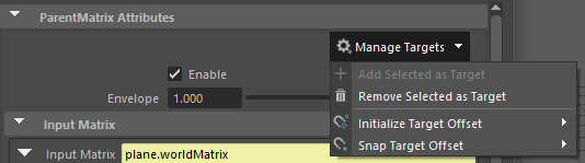

- Manage Targets
The parentMatrix node also has a Manage Targets menu. Select from the options:
ParentMatrix Manage Targets menu
Add/Remove Selected as Target Incorporates or removes the selected object from the matrix. Initalize Target Offset Calculates the offsetMatrix so that the object remains in the same place as the inputMatrix when the target becomes the single contributing influence (weight of the target is 1.0 and all others are 0.0). Snap Target Offset Calculates the offsetMatrix so that the object does not move from its current location when the target becomes the single contributing influence (weight of the target is 1.0 and all others are 0.0). . - Enable
