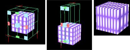

- Interactive Placement
Displays the Projection manipulators in the scene view.
Tip:Use Fit To BBox to center the manipulator around the object.
Using these manipulators in combination with Maya’s transform tools, you can orient and position the texture map in three dimensions. The manipulators for texture mapping are exactly the same as those used for texturing polygons. See the Polygon modeling overview in the Polygonal Modeling guide for details.

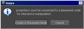

Note: If no place3dTexture node exists, Maya displays the following alert box:
Click the Create a placement node button to create the place3dTexture node.

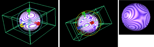

- Spherical
Places the texture inside a sphere and projects it onto the object.

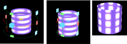

- Cylindrical
Places the texture inside a cylinder and projects it onto the object.

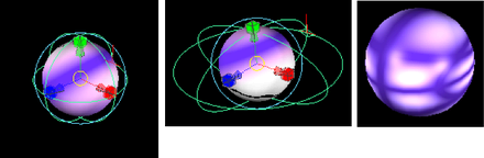

- Ball
Places the texture inside a ball and projects it onto the object. For example, Maya projects the texture as if a candy wrapper is pulled around a lollipop. There is one pinch point to the mapping at the -z-pole, as opposed to the two pinch points at the +y and -y poles in spherical and cylindrical mapping.

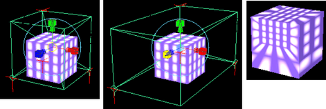

- Cubic
Defines the projection surface as a box. Maya places images on each plane and projects them onto the object.

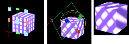

- Triplanar
Extrudes the texture along the axis defined by the maximum direction of the surface normal. The texture is projected much like fabric pulled around an arc.

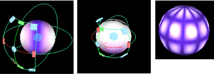

- Concentric
Projects a vertical slice of the texture from the inside to the outside edge of the voxel. The vertical slice used is randomly chosen for each voxel. A voxel is a 3D version of a rectangle—a voxel grid is a series of 3D cubes that line up to form a bigger cube.
