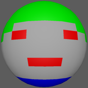

In this example is a head model, and its hair, skin, neck and eyes/mouth are all assigned to different materials.
The following workflow demonstrates how to create the following overrides:
  • color override on the model's hair
  • color override on the model's eyes and mouth
  • color override on the model's neck to connect it to a checker texture
  • replace the skin shader with a different shader using a shader override
The end result should appear as follows:

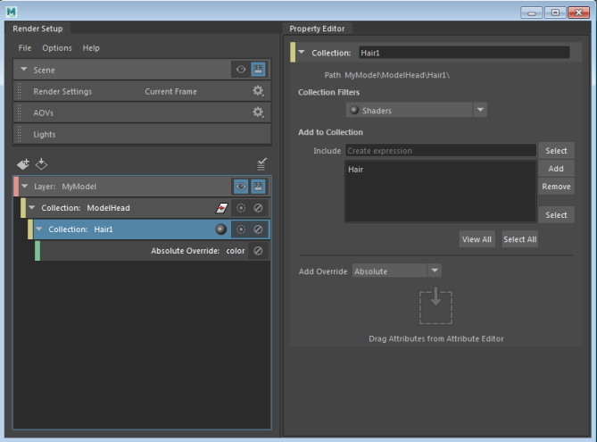

  1. Create a layer and name it MyModel.
    Click to make the layer visible.

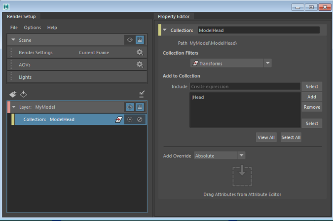

  2. Right-click the layer and select Create Collection, and name the collection ModelHead.
  3. With the ModelHead collection selected, select Head from the Outliner and click Add in the Property Editor to add it to the collection.
    The head model is now added to the layer.
    Note: By default, only its transform node is added to this collection.

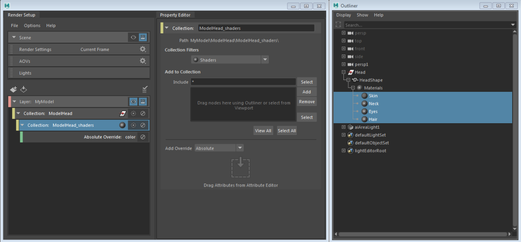

  4. In the Outliner, select any shader, for example, Skin. In the Skin shader Attribute Editor, middle-mouse drag and drop the Color attribute to the ModelHead collection Property Editor to create an override.
    A ModelHead_shaders sub-collection is created, along with a corresponding color override. Select this collection to see that the Collection Filters is set to Shaders in the Property Editor.
    Click Select All in the Property Editor to see that all of the Skin, Hair, Neck, and Eyes shaders are included in this collection. This collection contains all the shaders assigned to the head model.
  5. Click Add in the Property Editor, then remove Skin, Neck and Eyes, leaving behind only Hair. Remove the * from the expression field.
    This collection now contains only the Hair shader. Rename it to Hair.

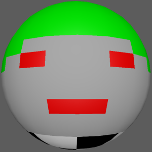

  6. Select the color override and change the color to green. The hair of the model turns to green in the viewport.

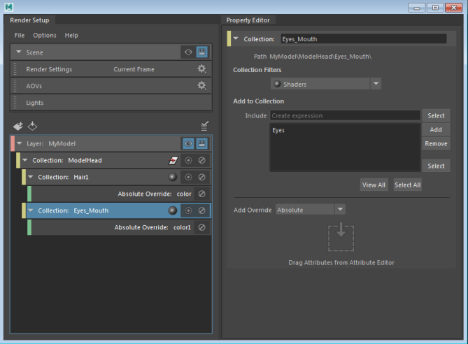

  7. With the MyModel layer still set as visible, select the ModelHead collection again, then select the Skin shader. In the Skin shader Attribute Editor, right-click the Color attribute and select Create Absolute Override for the Visible Layer.
    A ModelHead_shaders sub-collection is created, along with a corresponding color override. As before, all of the Skin, Hair, Neck, and Eyes shaders are included in this collection.
  8. With the ModelHead_shaders sub-collection selected, click Select All in the Property Editor, then Add, and then remove Skin, Neck and Hair, leaving behind only Eyes. Remove the * from the expression field.
    This collection now contains only the Eyes shader, which is applied to both the Eyes and Mouth. Rename it to Eyes_Mouth.
  9. Select the color override and change the color to red. The eyes and mouth of the model turns to red in the viewport.

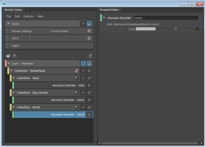

Connect a checker texture to the color attribute of the model's neck shader
  1. With the MyModel layer still set as visible, select the ModelHead collection again, then select any of the shaders; for example, Neck. In the Neck shader Attribute Editor, right-click the Color attribute and select Create Absolute Override for the Visible Layer.
  2. With the ModelHead_shaders sub-collection selected, click Select All in the Property Editor, then Add, then remove Skin, Eyes and Hair, leaving behind only Neck. Remove the * from the expression field.
    Rename this collection to Neck.
  3. Select the color override, and click the button to connect the Color attribute to a texture such as Checker.
    The neck of the model appears with a checkered texture in the viewport.

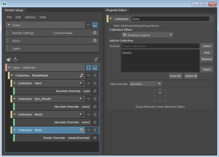

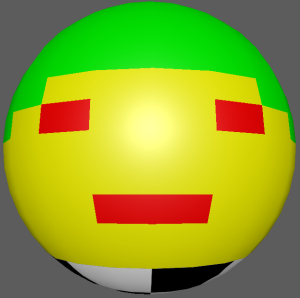

Replace the model's skin shader with a different shader using a shader override
  1. Select the ModelHead collection and right-click and select Create Shader Override.
    A collection named ModelHead_shadingEngines is created, along with a corresponding shader override. Select this collection to see that the Collection Filters is set to Shading engines. This collection contains all the shading engines applied to the head model.
    Rename this collection to Skin.
  2. In the Outliner, select SkinSG and click Add in the Property Editor to add it to the collection. Remove the * from the expression field.
  3. Select the shader override and click the icon to connect the SkinSG shading engine to a different shader, such as blinn.
    Adjust the color on the blinn shader and see the skin on the model update in the viewport.
