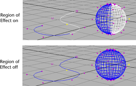

- Region of effect
This option lets you turn on or off the region of effect display. Region of effect is the part of an object that potentially changes as a result of moving selected CVs. Curves show the region of effect as well as surfaces. The default is on.
