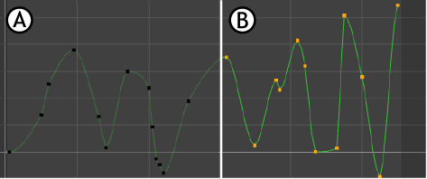

Allow edits on referenced animation curves
Select to allow editing of animation curves from referenced files. See Edit animation curves from referenced files.When an animation curve is referenced in the Graph Editor, it appears in a dim color (40% of the original curve color) with black locked keys.
Animation curve in the Graph Editor: A. Referenced locked, B. Referenced, unlocked
