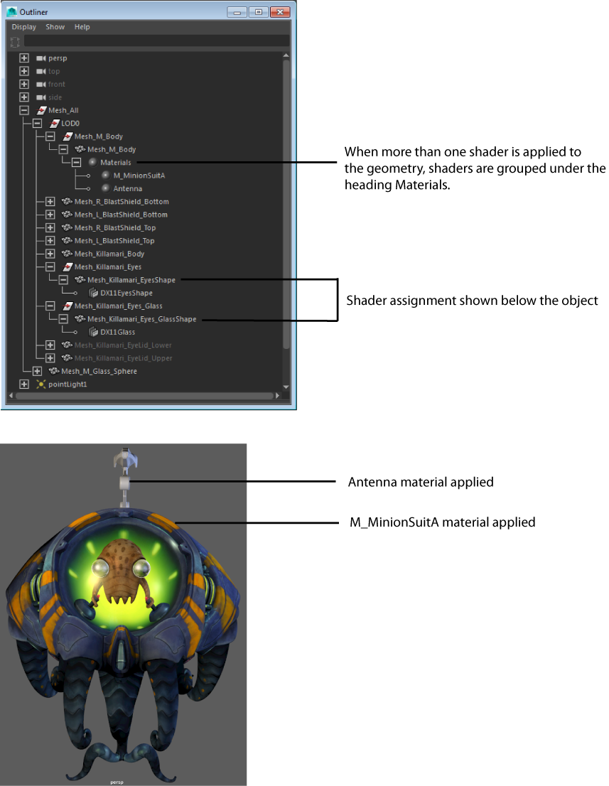

Identify shaders assigned to each object in the scene
Display the shader assigned to each object in the scene by enabling the Display > Assigned Materials option in the Outliner.
If your object involves per-face shader assignments, then all shaders assigned to the object are listed, and grouped under the heading Materials.
