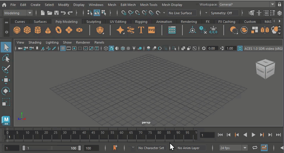

To create a custom menu set
- Select the
Status Line menus drop-down list, and then select
Customize.
Open the Menu Set Editor
The Menu Set Editor appears.
- Select Edit > New Menu Set.
- Enter a unique name for the custom menu set.
- Select
Create.
The new custom menu set appears in the Menu sets column, the Status Line drop-down list, and the Hotbox.
