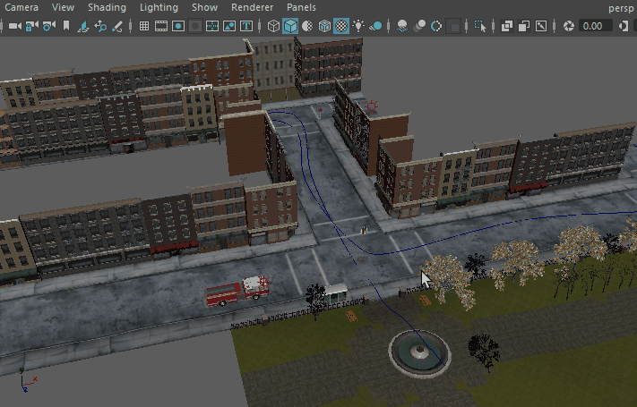

If you have more than one camera, you can switch the camera through which you are viewing the scene.
To look through a camera
- Do one of the following:

Camera views are found in the
Panels menu that is located along the top of the scene view. If the
Panels menu is not visible, press
Shift+M to show or hide the
Panels menu.
