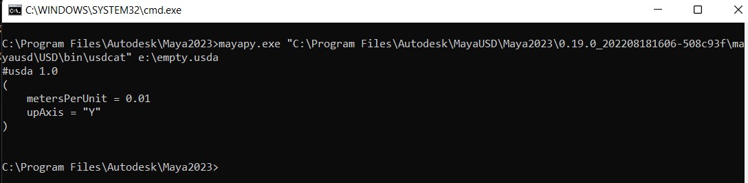

2. To run UsdView and other tools from the Command Line
Compatibility Note: The version of MayaUSD shipped with Maya 2022 was built using python from Maya and
mayapy
, so UsdView will run withmayapy
.To run with Python 2, usemayapy2
(instead of "mayapy") and change toUSD2
(from “USD3”). UsdView is accessible for other versions of Maya. However, Maya 2022 provided dual support for python 2 and python 3.
The simplest way to set up an environment that matches the maya environment is to use the Script Editor to locate the paths to the USD toolset, launch a shell and use the commands from there:
import maya.cmds as cmds
import os
import sys
import subprocess
mayaVer = int(cmds.about(q=True, majorVersion=True))
if mayaVer == 2022:
mayapyPath = os.path.join(os.environ['MAYA_LOCATION'], 'bin', 'mayapy{ver}'.format(ver='' if sys.version_info.major == 3 else '2'))
else:
mayapyPath = os.path.join(os.environ['MAYA_LOCATION'], 'bin', 'mayapy')
usdRootPath = os.environ['USD_LOCATION']
# sanitise the path separators - slightly inefficient
mayapyPath = mayapyPath.replace('\\', os.path.sep).replace('/', os.path.sep)
usdRootPath = usdRootPath.replace('\\', os.path.sep).replace('/', os.path.sep)
# finally build out the nice pathing
usdToolsPath = os.path.join(usdRootPath, "bin")
usdLibPath = os.path.join(usdRootPath, "lib")
mayapyBinPath = os.path.dirname(mayapyPath)
path_divider = ";" if sys.platform in ('win32') else ":"
print(" usdtools: {}".format(usdToolsPath))
print("minimum path set: {}".format(path_divider.join([mayapyBinPath, usdToolsPath, usdLibPath])))
subprocess.Popen(['cmd']) # or powershell, bash, zsh, tcsh - your shell of choice
At the command shell you can then run the tools via the mayapy
interpreter:

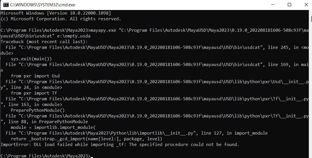

TROUBLESHOOTING:
If you see errors about DLL/SO load failures:
It is possible that your shell has additional paths, the minimum set of paths needed are:
- Path containing the mayapy binary
- Path containing the usd binaries
- Path containing the usd libraries
The script will print these paths to the Script Editor.
