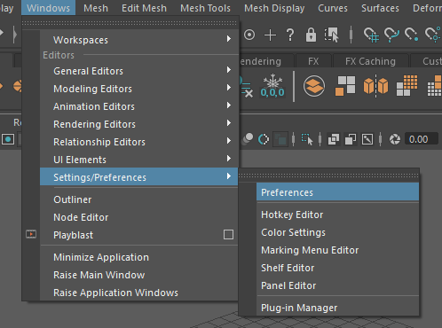

- In the Maya menu bar, go to
Windows>Settings/Preferences >
Preferences.

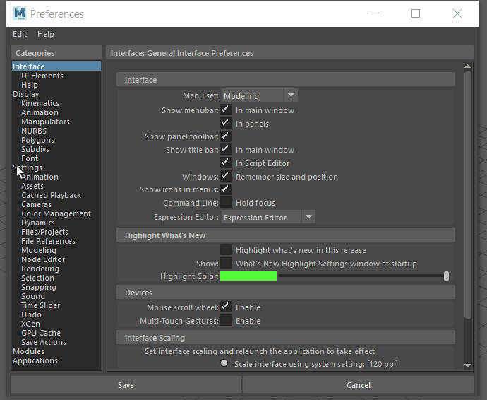

- In the Settings category, locate Working Units.
- In the
Linear drop-down menu, select your preferred working unit.
