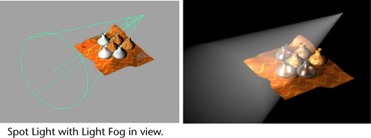

- Use a spot or point light in the scene. This example uses a spot light.
- In the spot light’s Attribute Editor’s Light Effects section, click the Light Fog map button to map it to the light.
The spot light’s icon increases in size. If necessary, bump up the Fog Spread and Fog Intensity values.

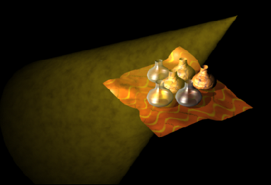

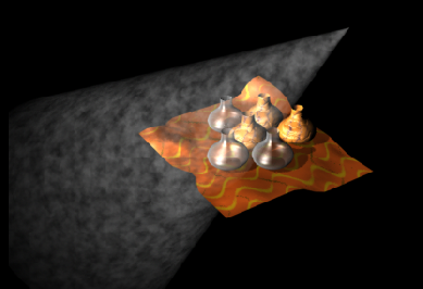

- Open the Volume Shader’s Attribute Editor and map a texture, such as cloud, to the Out Color attribute. The following shows the rendered result.
Change the Cloud texture’s attributes to change the fog effects if necessary.
