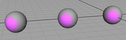

To create shared Color Per Vertex data per instance
- Select one of the instances.
- Select .
The Color Set Editor appears. See Color Set Editor Options.
- In the Color Set Editor, click New.
The Create Empty Color Set Options window appears. See Create Empty Color Set Options.
- Set Color Set Sharing to Per Instance Shared.
- Click Apply and Close.
- Color vertices on the instance with either or .
The painted colors appear on all instances of the object (including the source).

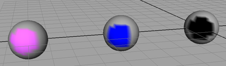

To create unshared Color Per Vertex data per instance
- Select .
- Set Color Set Sharing to Per Instance Unshared.
- Select another instance of the object you want colored differently and repeat steps 3-6.
Each instance you create a new unshared color set for, is colored differently. If you rename one of these unshared color sets, the corresponding unshared color sets on other instances are renamed accordingly.
