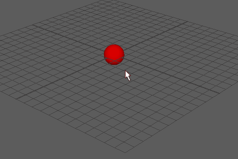

A camera with a Clipping plane of 40. The grid disappears as the camera pulls near.
When working on large scenes or importing data from other applications, you may notice that part of your scene is missing. When you press F, the whole scene seems to disappear. Furthermore, you may notice artifacts in your scene when you zoom in and out.
If this occurs, you may want to adjust your clipping plane.
