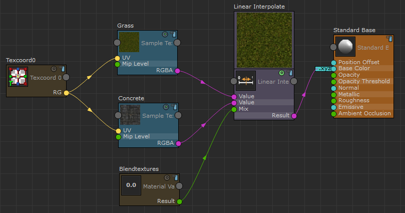

To create a texture map
To create a texture map, create a Sample Texture node, and connect to it your file texture.
You must connect a UV set node (for example Texcoord 0) to the UV attribute of Sample Texture to set the texture co-ordinates of your object.
The following simple network demonstrates how to combine two textures using a Linear Interpolate Mix node and control the contribution of each texture using a Scalar value.
Textures courtesy of www.cgtextures.com

The name of your attribute is the taken from the name of your node. Therefore, you may want to change the default names of the nodes. In the example above, the default name texture map 5881422 was changed to Grass so that Grass (instead of texture map 5881422) appears as an attribute in the Attribute Editor when the ShaderFX editor is closed. To rename a node, select it and enter a new name in the Name field in the Attribute Editor.
