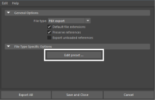

- Select
FBX export from the
General Options
File type menu.
The Edit Preset button appears in the File Type Specific Options.
- Click
Edit Preset to show the
Export/Import Options dialog box.
