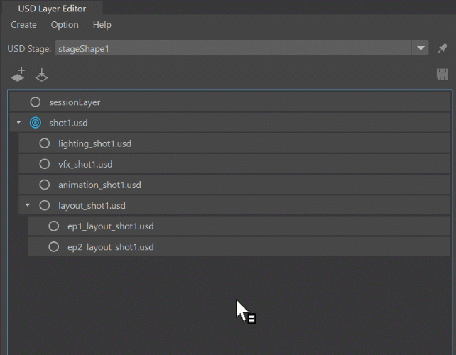

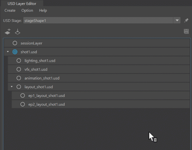

To move a single sublayer, click and hold to drag and drop the layer into a new location. To move multiple layers, use shift or control to select multiple layers to drag and drop.
The following happens when you drag a layer:
  • When dragged on top of another layer, a white box appears indicating that the layer will become a child of this layer.
  • When dragged above or below another layer, a white line appears indicating that the layer will become a sibling of the other layers.

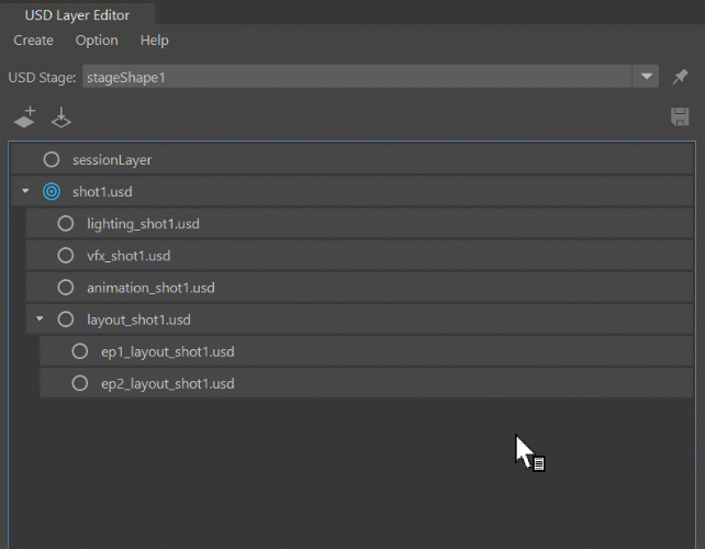

The following rules affect placement:
  • If a layer is dragged over a parent layer, it becomes the first sublayer inside the parent.
  • If the layer being dragged is a parent, all of its descendants are also moved to the new location to preserve the existing hierarchy.
  • If the layers being dragged are siblings, these layers and all of their descendants are dragged to the new location as siblings.
  • If the layers being dragged are not siblings, these layers and all of their descendants are dragged to the new location as siblings
  • If the layer being dragged is set as the target layer, it remains the target layer after it is moved.
  • If a layer has a relative path, it cannot be parented to a new anonymous layer, because sublayers are saved as relative only to their parent layer, see Make Path Relative
