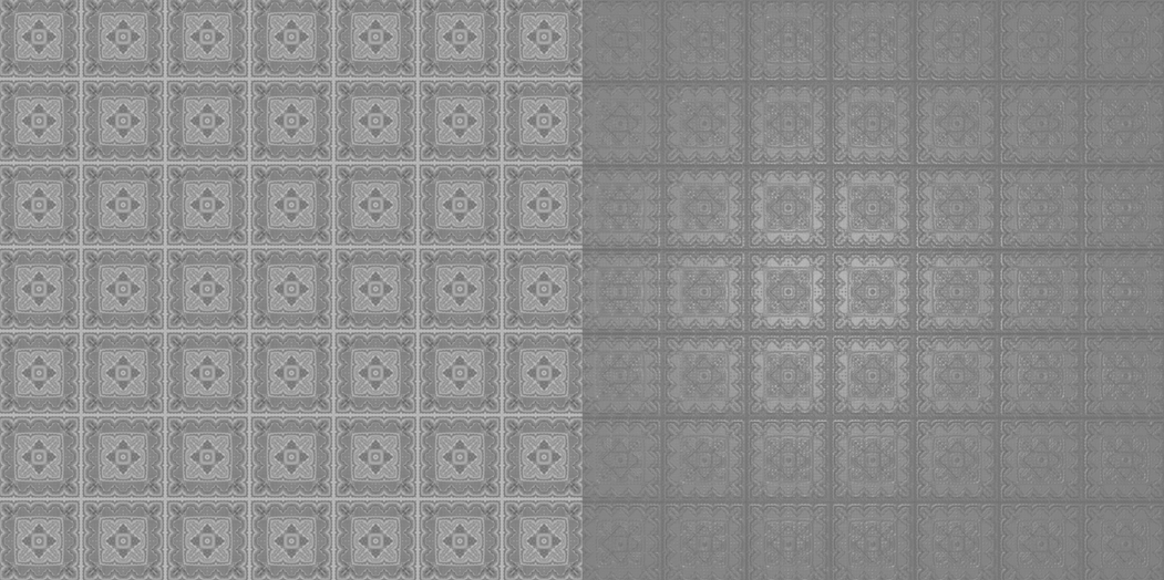

Noise Shaders
Noise Type 1
Octaves: 1. Distortion: 1.2. Lacunarity: 1. Scale XYZ: 10
Noise Type 2
Octaves: 1. Distortion: 5.2. Lacunarity: 1. Scale XYZ: 10.

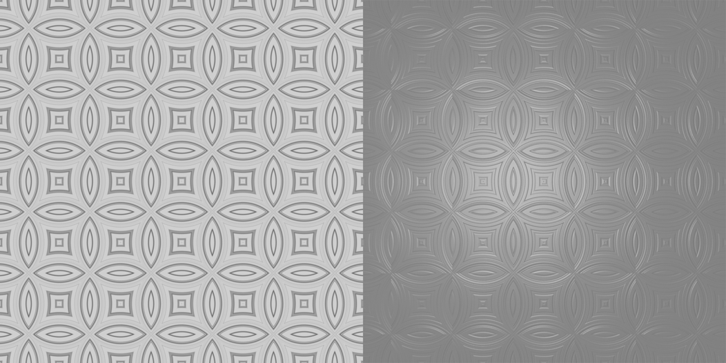

Noise Type 3 (Noise x2)
Create a Noise shader and set the following parameters:
  • Octaves to 1.
  • Distortion to 5.
  • Lacunarity to 3.25.
  • Scale XYZ to 0.
Next, create another Noise shader and connect its output to the Offset parameter of the first Noise shader. Set the following:
  • Octaves to 5
  • Distortion to 4
  • Lacunarity to 1
  • Scale XYZ to 5

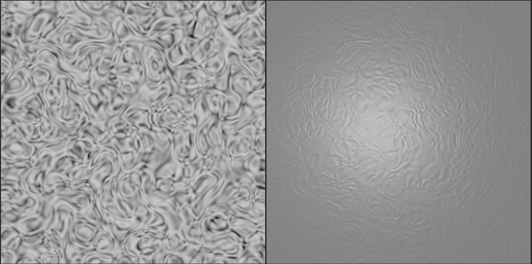

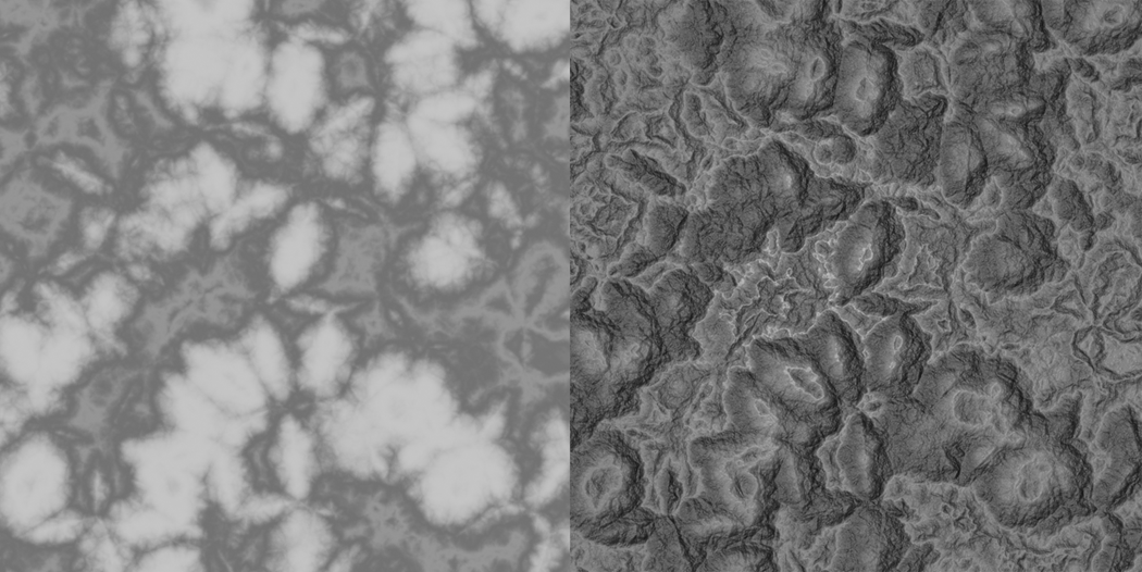

Noise Type 4 (Noise x2)
  • Octaves to 1
  • Distortion to 5
  • Scale XYZ 10
Next, create another Noise shader and connect its output to P parameter of the first Noise shader. Set the following:
  • Octaves to 2
  • Distortion to 3
  • Lacunarity to 1
  • Amplitude 0.21
  • Scale XYZ to 5

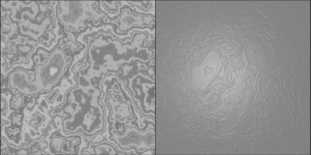

Noise Type 5 (Noise x2)
  • Octaves to 1
  • Distortion to 6.7
  • Lacunarity to 1
  • Scale XYZ 5
  • Octaves to 4
  • Distortion to 0
  • Lacunarity to 2.68
  • Amplitude 0.719
  • Scale XYZ to 10

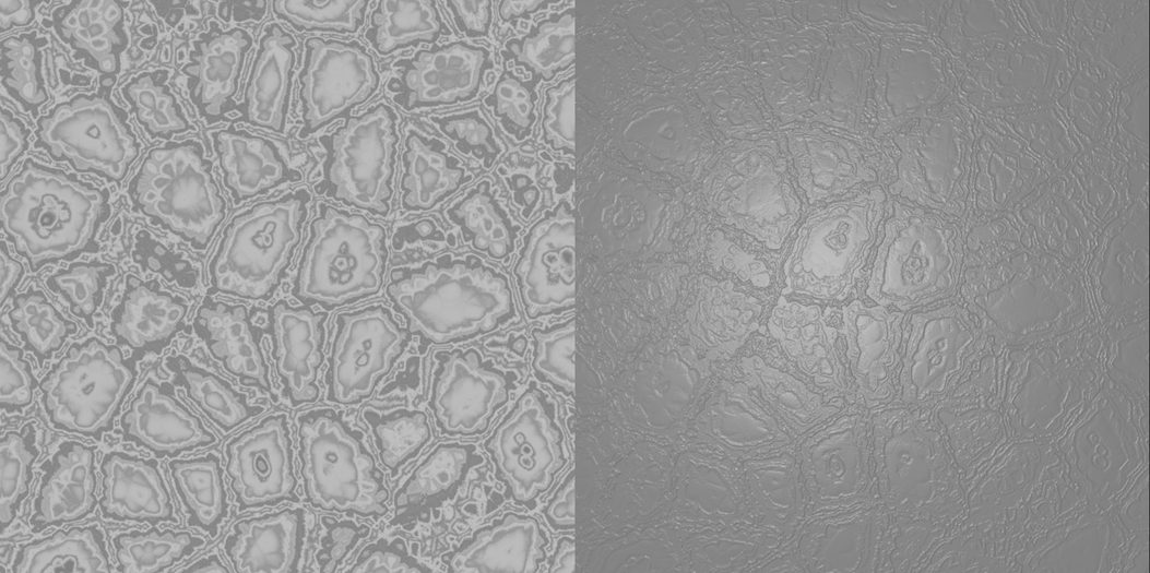

Noise Type 10 (Cell Noise ->Noise)
  • Octaves to 1
  • Distortion to 3.533
  • Lacunarity to 1
  • Scale XYZ 6
Next, create a cell_noise shader and connect its output to P parameter of the first Noise shader. Set the following:
  • Change Pattern to alligator
  • Enable Additive
  • Octaves to 3
  • Lacunarity to 5
  • Amplitude to 0.920
  • Scale XYZ to 7
  • Density to 0.549
  • Randomness to 0

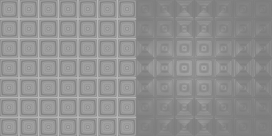

Cell Noise Type 2 (Cell Noise -> Range)
Create a cell_noise shader and set the following parameters:
  • Disable Additive
  • Octaves to 2
  • Lacunarity to 1.5
  • Amplitude to 1
  • Scale XYZ to 10
  • Density to 0.326
  • Randomness to 0
Next, create a range shader and connect the cell_noise to its input parameter. Set the following:
  • Input Max to 0.343
  • Enable Smoothstep

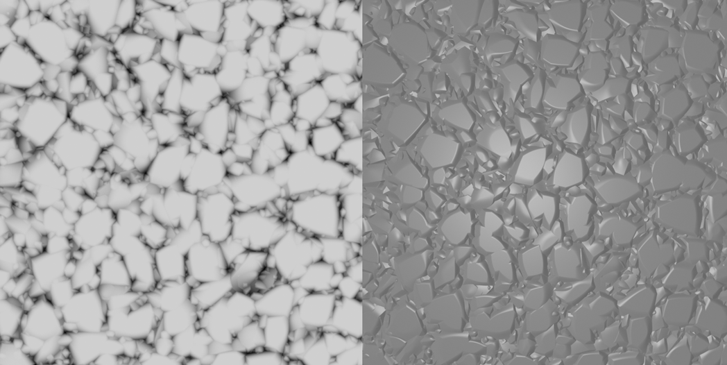

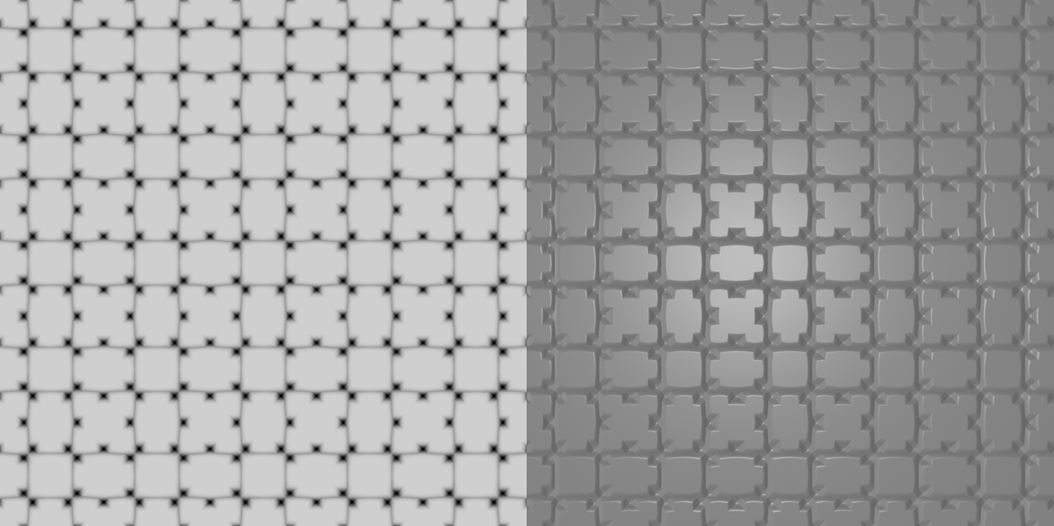

Cell Noise Type 3 (Cell Noise -> Range)
  • Disable Additive
  • Octaves to 6
  • Lacunarity to 1.297
  • Amplitude to 1
  • Scale XYZ to 10
  • Density to 0.326
  • Randomness to 1
Next, create a Range shader and connect the Cell Noise to its input parameter. Set the following:
  • Enable Smoothstep

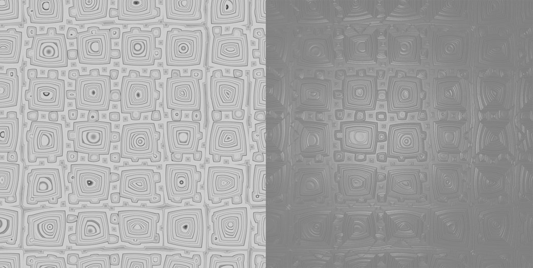

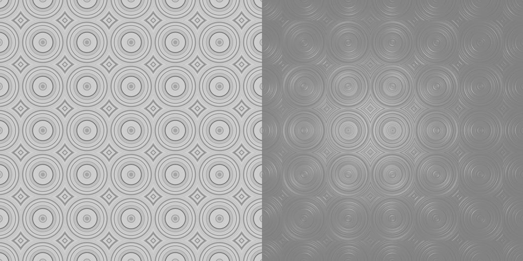

Cell Noise Type 4 (Cell Noise -> Cell Noise -> Range)
  • Enable Additive
  • Set Octaves to 3
  • Amplitude to 1
  • Scale XYZ to 10
  • Density to 0.326
  • Randomness to 1
Create another cell_noise and connect its output to P parameters of the first Cell Noise. Set the following:
  • Change Pattern to worley2
  • Enable Additive
  • Octaves to 3
  • Lacunarity to 1
  • Amplitude to 1
  • Scale XYZ to 6
  • Density to 0.5
  • Randomness to 0
  • Enable Smoothstep

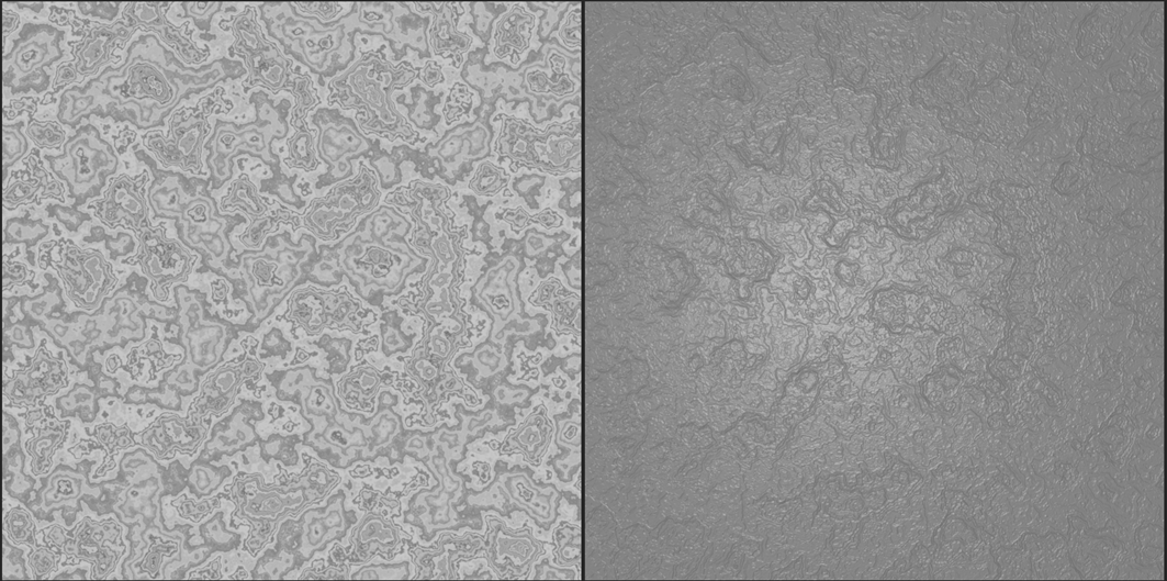

Or set parameters in the second cell_noise to get a result like in the image below:
  • Change Pattern to worley1
  • Disable Additive
  • Octaves to 3
  • Lacunarity to 1
  • Amplitude to 1
  • Scale XYZ to 6
  • Density to 0.5
  • Randomness to 0
  • Disable Additive
  • Octaves to 2
  • Lacunarity to 2.189
  • Amplitude to 1
  • Scale XYZ to 6
  • Density to 0.5
  • Randomness to 0.183
