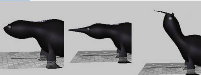

A seal's initial state is shown on the left, the seal's tweaked nose is shown in the middle, and the seal's rotated neck is shown on the right.
In the initial state, the seal shape is skinned to a skeleton so that rotating the various joints creates a smooth skinning deformation. Later, the seal's nose is grown by moving a few vertices in X axis. In this example, there is no tweak node, so the vertex deltas are stored in the shape node. Everything looks alright until the neck is rotated. Because the tweaks get added after the skinning deformation, the deltas move the nose vertices in X axis even though the seal's nose is no longer aligned with the X axis. To rotate the seal's neck without disfiguring the nose, the skinning algorithm must act on the seal's tweaked nose instead of having the tweaks act on the seal's skinned nose.
