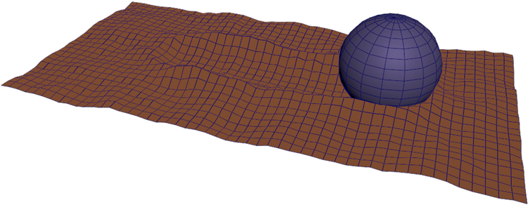

Query data on geometric objects
Geometry queries let you sample data from geometric objects, such as the interpolated value of vertex colors across a mesh's surface. A query returns locations or component indices on an object, and then you use those results to look up the corresponding values of one or more existing properties.
