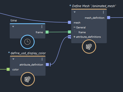

The frame input is available on the define_usd_mesh and define_usd_attribute nodes.
- If you want to animate specific attributes and not the whole prim, connect
timetodefine_usd_attribute. - To animate the shape, connect
timetodefine_usd_mesh. - If the attribute values to animate are connected to the
attribute_definitionsport of adefine_usd_meshnode that is already set up for animation, then you do not need to connecttimeto thedefine_usd_attributenodes individually.
You can edit the existing compounds or build your own to animate other prim types or specific attributes.
In the parameters of a
define_usd_meshordefine_usd_attributenode, enableuse_frame.Connect the
frameoutput of atimenode to theframeinput. In the following example, the display color attribute will be animated as well because the mesh itself is animated.

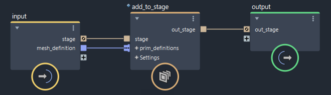

Select the
add_to_stagecompound downstream, and press Ctrl+G to make a compound.
Double-click the compound to enter it.
Right-click on the
stageport of theinputnode and choose Set Port Feedback > out_stage. The ports are now linked as feedback ports.
Exit the compound and play the scene through to accumulate the animated data in the stage.

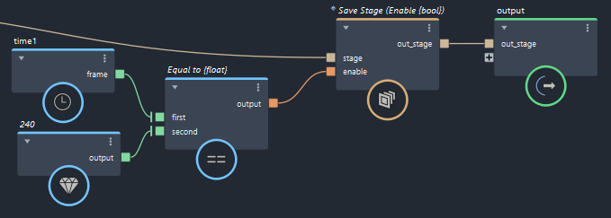

After playing through, you can save or export the stage to file.
If desired, you can create a condition to save automatically on the last frame.
