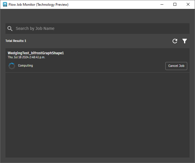

The Flow Job Monitor shows the status of your recent wedging and other Flow jobs.
Open the Flow Job Monitor
  • Select Flow Graph Engine > Flow Wedging (Technology Preview) > Open Job Monitor or Flow Graph Engine > Open Web Monitor (requires Autodesk sign-in on the web).
Flow Job Monitor showing progress
Interface Description
Search by Job Name Type to find a specific job submission and track its status.
Refresh Icon Refresh the displayed status of jobs in progress.
Filter Icon Sort the list in various ways.

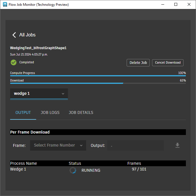

Click on a job to view more details, like the status of specific wedges and frames, job logs, and more. Click All Jobs to return to the main list.
Details of a job
