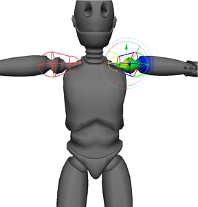

- Reflection
Turns manipulator reflection on or off. When on, modifying a manipulator on one side of the mesh also modifies the corresponding manipulator on the opposite side. The reflected manipulator displays as a red templated manipulator object. In this example image, modifying a manipulator for the left shoulder also displays and modifies the manipulator for the right shoulder.

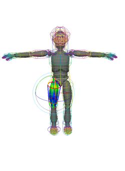

- All
Display wireframe manipulators for all influences. When this Display mode is on, you can use the pickwalk hotkeys to select manipulators. Each wireframe manipulator displays in the same color as its respective influence.
