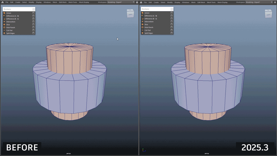

Coincident Vertices
When vertices are perfectly on top of one another, booleans could previously fail due to misunderstanding this type of geometry. In the following example, the sphere and torus have vertices perfectly aligned. This operation would not succeed in past versions and now performs seamlessly.
Booleans could also cause issues downstream previously when it produced ouput meshes that incorrectly created coincident vertices. This update resolves coincident vertices and avoids generating them, as seen in the following example.

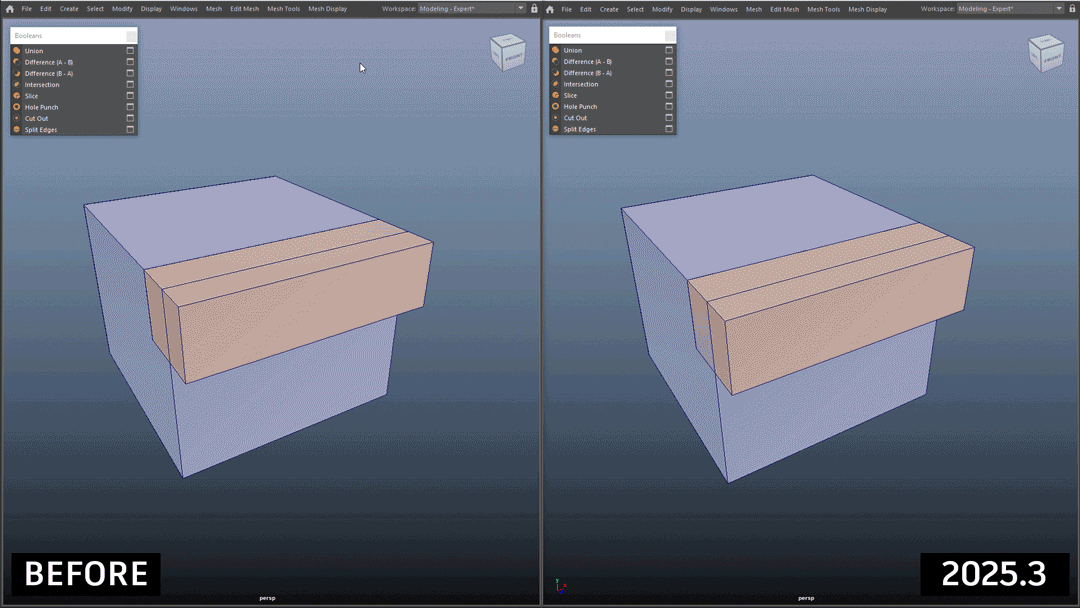

Coplanar Geometry
In previous versions, the boolean operation could produce unexpected results with coplanar geometry. Now, the operation resolves any overlapping surface discrepancies that impact the result.
