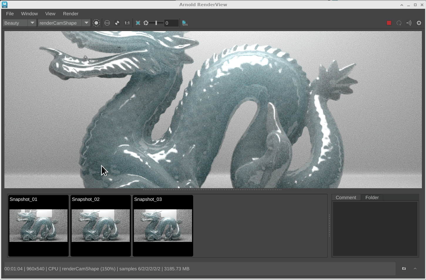

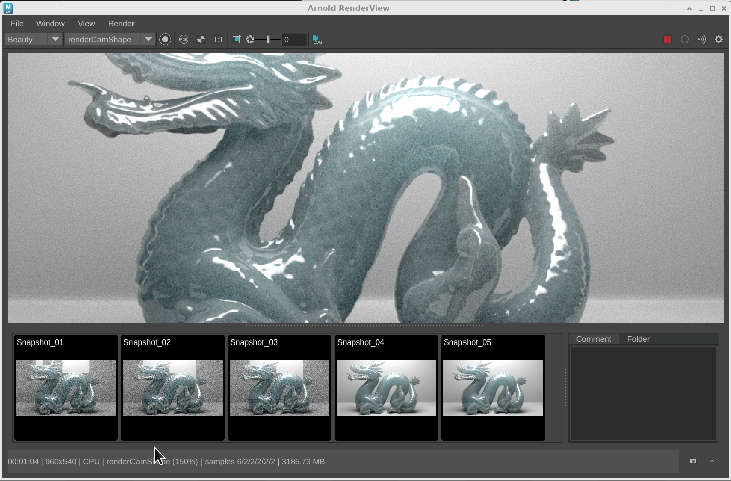

Improvements to the Arnold Render View Snapshots
The snapshot workflow and interface in the Arnold RenderView has multiple enhancements and behaviors.
  • Press the S hotkey in the Arnold RenderView to save a snapshot.
  • Improved UI for Snapshot buttons (ARNOLD-232)
  • You can now compare snapshots of the same resolution using the Ctrl key modifier when selecting a second snapshot.
  • You can now select multiple snapshots with the Shift modifier and delete multiple selected snapshots with the Del key.

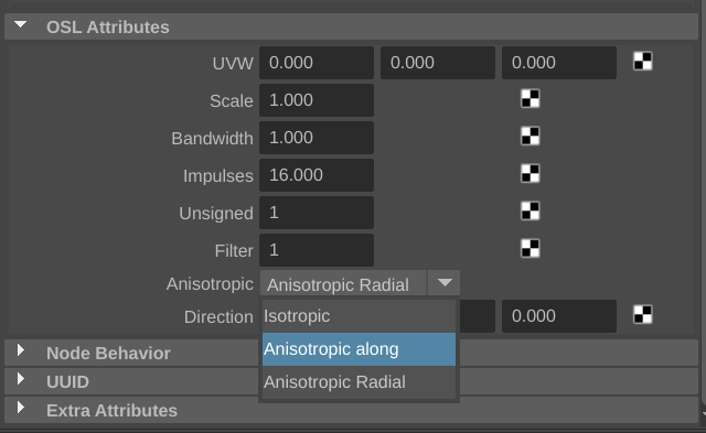

OSL Enum support in Attribute Editor
Shader parameters of type ENUM on the OSL code node create a combo box with the available options (MTOA-1781)
OSL enum parameter values displayed as a drop-down list

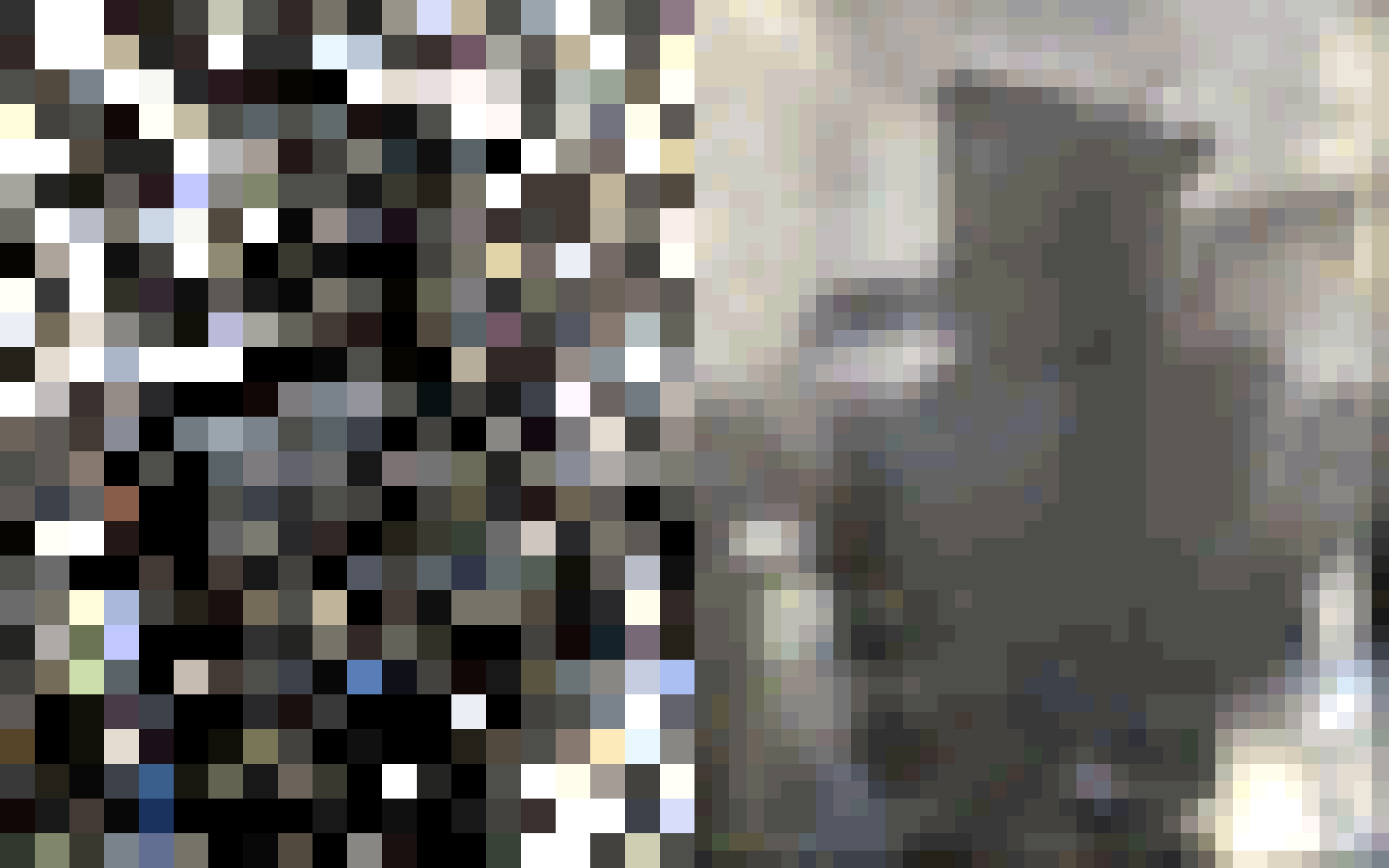

  • OptiX denoiser runs on progressive negative AA passes: The OptiX denoiser imager now denoises the low-resolution progressive passes (renders with AA < 0). This should result in higher quality feedback in IPR. (ARNOLD-11487)
    Left side shows the previous behaviour where denoising was only applied to the AA > 0 passes. Right side is new behaviour where all progressive passes are denoised.
