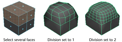

- Division Levels
Use the slider or type a number in the Division levels box to increase or decrease the number of times Maya performs the smoothing operation. This also increases or decreases the object’s smoothness. The Division levels range is from 1 to 4. The higher the value, the smoother the object.

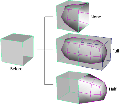

- Mirror Behavior
Controls how the smooth mesh and proxy mesh are mirrored and/or located relative to each other.
- None
The smooth mesh is created within the proxy mesh.
- Full
The smooth mesh is created within the proxy mesh, and both the proxy mesh and the smooth mesh are mirrored about the Mirror Direction.
Adjustments that you make to one half of the proxy mesh are automatically mirrored onto the other half, making symmetrical modeling much easier.
- Half
The smooth mesh is created adjacent to the proxy mesh (based on the Mirror Direction). This allows you to modify the proxy mesh and clearly see the result on the smooth mesh.

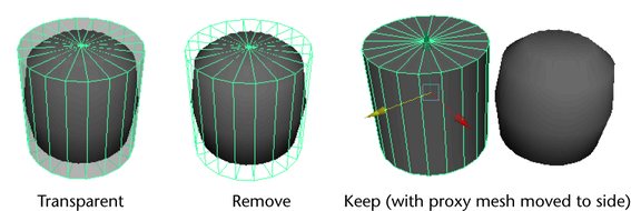

Display Settings
- Subdiv Proxy Shader
Controls the appearance of the proxy mesh’s material to best suit the way you like to work.
- Remove
- Eliminates the connection between the proxy mesh and its material.
- Keep
- Maintains the original connection between the proxy mesh and its material. If you choose Keep, you’ll need to move the proxy and smooth mesh side-by-side.
- Transparent
- Assigns a new Lambert material with partial transparency to the proxy mesh. This lets you view the smooth mesh beneath the proxy.
