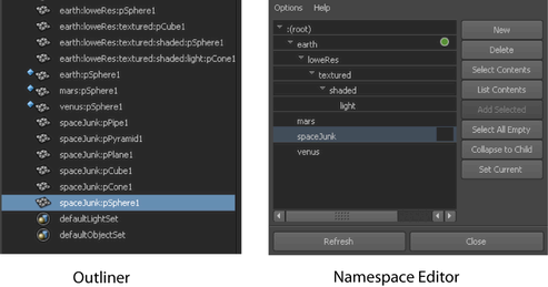

- Determine the namespace for a node by selecting any object/node that uses the namespace.
The namespace for the object/node appears highlighted in the Channel Box and Outliner. For example, an object’s name with an assigned namespace can appear as follows:
spaceJunk:pSphere1
- In the
Namespace Editor, select the namespace you want to remove.
- Click
Delete.

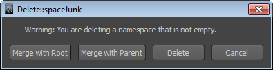

If the namespace you want to remove contains nodes, the Delete: namespace window appears.
- In the
Delete: namespace window, click one of the following:
- Merge with Root to merge the namespace and move the nodes contained by the deleted namespace to the root namespace.
- Merge with Parent to merge the namespace and move the nodes contained by the deleted namespace to an immediate parent namespace.
- Delete to delete the namespace and the nodes contained by the namespace.
