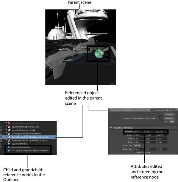

When the objects of a referenced file are modified in the parent scene, the edits are recorded and stored in a reference node. A reference node is created in the parent scene file for each child scene file it references. In the Outliner, a reference node is indicated by an icon.
Reference edits made in the parent scene do not propagate to the original child scene file so it remains unmodified. For example, a tree that is referenced into the parent scene can be scaled and repositioned without the original tree reference file being affected. It appears scaled and repositioned only in the parent scene because the translations and scale attributes are being stored in a reference node within the parent scene.
One can think of a reference node as an attribute storage area that keeps track of modifications to the attributes, dependency graph connections, and DAG hierarchy changes that occur for any file referenced by the parent scene. A reference node does not store edits to references that are above it in the file referencing hierarchy. For example, if you edit a child reference, the edits are not recorded by the reference nodes of any of its grand-child files.

You can view the edits made to a referenced file by right-clicking its reference node in the Outliner and selecting Reference > List Edits from the menu that appears.
