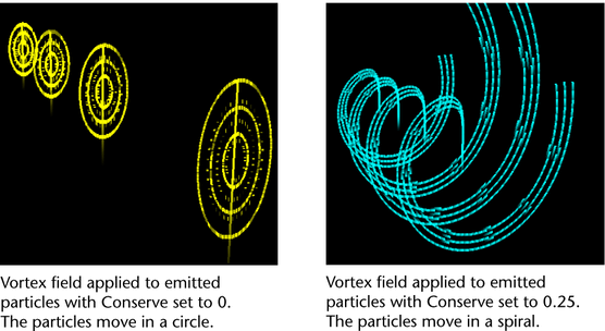

Tip:If you use a vortex field with a particle object, you can set the Conserve attribute of the particle object to influence of the motion. If you set Conserve to 0, the particle object moves in a circular motion. If you set Conserve greater than 0, you get a spiraling motion.
