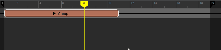

For Group clips, when you shorten a clip, the same black dot appears at the trimmed end of the group clip. However, clips inside the Group clip have a black dot with a circle around it to indicate that the animation extends beyond the clip except that the Group clip has been shortened (that is the clips inside the Group have inherited the Group's trim). When you extend a Group clip, the same white dot appears to show that it continues past the animation.
