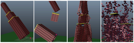

Compound Examples: A tower made of 1000 bricks in a Rigid Body solve. The first tower is a compound object, while the second has each of its three tiers set as compound objects. The last two images show the individual brick set as Hull and Cube-type objects.
