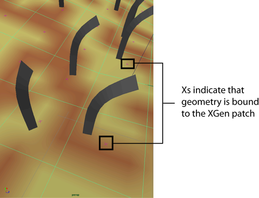

In the Outliner, patches are identified by this icon: . In the scene view, areas bound to XGen patches display with a magenta-colored X at the center of the geometry faces. Patches do not have attributes to modify. You can change which polygon faces bind to the patch by using the Bind Face menu options.
