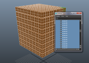

When you work with simulations that rely on numerous objects in the solve, for example, a wall made of thousands of bricks, it can significantly affect the performance of the simulation. Additionally, it can be tedious to select each object in the Outliner. In these cases, it is best to create a Rigid Set that comprises all of the Rigid Body objects included in the solve.
- There is no rigid set support for compound and auto-compound collision shapes.
- Freeze scaling before you create a Bullet Rigid Set. Scale transform values are not correctly transferred to the resulting solved object .
To create a Rigid Set from multiple objects:
- Open the
Outliner and Shift-select all the objects or groups you want to include in the solve. If you select a group, all non-intermediate mesh shapes found under the group are added as a rigid body.
- Go to
Bullet >
Create Rigid Set >
. Creating a Rigid Set groups all the selected objects so you can select them quickly in the
Outliner.

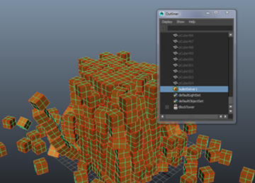

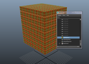

- Select the Solver in the
Outliner, and turn on
Bounding Box
in the
Solver Display options in the
Attribute Editor to see the collision boundaries.
- Turn on Ground Plane so that your objects will collide with a surface.
- The output mesh is used to visualize the simulation.
- Press
Play to watch the simulation.
